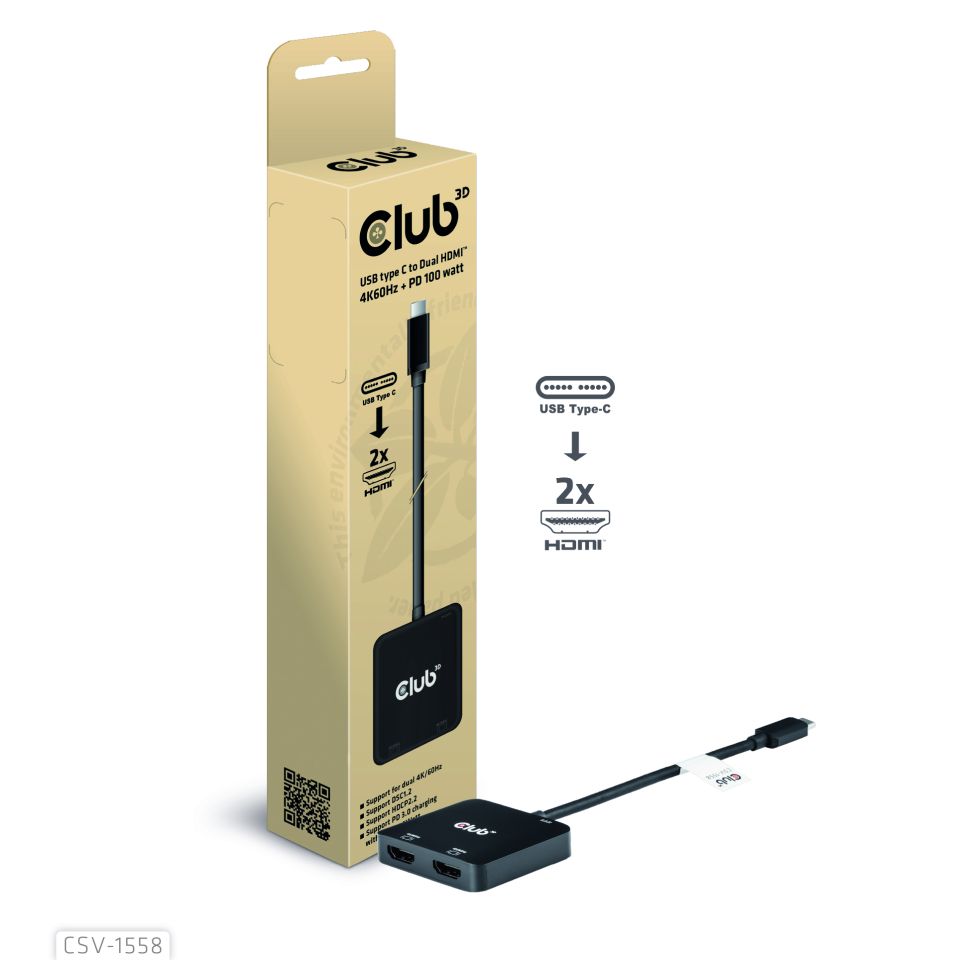

The Club 3D CSV-1558 USB Type-C to Dual HDMI™ 4K60Hz + PD 100 Watt Charging under DP1.4 Alt mode, allowing to extend the USB Type-C port of the host to 2x HDMI™ displays with ultra high definition max 4K60Hz for each display simultaneously. Supporting MST function, dual displays can be showed with different video contents simultaneously. Besides, it supports PD Charging with max 100 Watt. It can work on all DP™ Alt mode supported USB Type-C or Thunderbolt™ devices (including Phones with an USB Type-C connetion and DP™ Alt modesupport).

Product Name: USB Type-C to Dual HDMI™ 4K60Hz + PD 100 Watt
Produktserie: Adapter
Artikelcode: CSV-1558
EAN code: 8719214472979
UPC code: 841615102914
• Support DP1.4™ Alt mode with max 8.1Gbps per lane, 32.4Gbps 4 lanes
• Support to output dual 4K/60Hz with different pictures under MST mode when working on Windows System
• Support to output dual 4K/60Hz with the same picture under SST mode when working on Mac OS System
• Support DSC1.2
• Support HDCP2.2
• Support HDR
• Support PD 3.0 charging with max 100Watt on separate USB Type-C port
- 1x Type-C Male (to host)
• Support DP1.4 Alt mode with max 8.1Gbps per lane, 32.4Gbps 4 lanes
• Support reversible connection
- 2x HDMI™ Female
•Support to output dual 4K/60Hz with the same picture under SST mode when working on Mac OS System
• Support 8/10/12 bit color depth output
• Support output pixel format RGB4:4:4/YCbCr4:4:4/YCbCr4:2:2/ YCbCr4:2:0
• Support DSC1.2
• Support HDCP2.2
• Support HDR
• Note1: to achieve dual max 4K/60Hz, the host should support DP1.4 Alt mode, when working on DP1.2 host, dual max 4K/30Hz due to bandwidth limitation.
• Note2: HDR support ensures every moment of a video is displayed at its ideal values for depth, detail, brightness, contrast and wider color gamuts—on a scene-by-scene or even a frame-by-frame basis
-1x USB Type-C Female PD Charging
• Support PD 3.0 charging with max. 100Watt
Note3: For PD charging your host device please use our CAC-1511 or CAC-1573 cables.
• Windows 10 or upwards, Mac 13.5.2
• 1X CSV-1558 USB Type-C to Dual HDMI™ 4K60Hz + PD 100 Watt
• 1x USB Type-C Male
• 2x HDMI™ Female
• 1x USB Type-C Female(for PD Charging) the host device Max. 100Watt
• Box size: 6 x 24 x 3.5 cm / 2.36 x 9.45 x 1.38"
• Device size: 5 x 5.5 x 0.9 cm / 1.97 x 2.16 x 0.35"
• Input Cable length approx.: 15 cm / 5.91"
• USB Type-Connector dimensions: 2.9 x 1.2 x 0.5 cm / 1.14 x 0.47 x 0.2"
• Device Weight: 45 gr / 1.59 oz
• Box Weight: 28 gr / 0.99 oz
• Bio Degradable Bag size: 9 x 30 cm / 3.54 x 11.81"
• Bio Degradable Bag Weight: 1 gr./ 0.04 oz
• Total Weight: 74 gr / 2.61 oz
